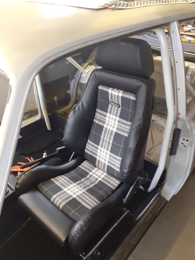

This is my very first go at any upholstery, so be gentle. Its not perfect, but not bad for a first attempt ?
#9603
@B1N9S ,
Brave man. I have 02 sitting here and 02 more in the chute. You did a great job! Interesting fabric choic though.
#9605
Dude! Thats actually a really really good for your first time! You should be proud. There are some areas to improve on but also know that that style of seat is one of the hardest to do.

By B1N9S
#10497
Pulled this one apart over the last couple of days. It's been sat there for months. I am having a nightmare trying to sew the 4 way shoulder junctions.
I decided to sew a top stitch across the join, but for the life of me I cannot get that junction to sit correctly and have the stitching line up. I am tearing what's left of my hair out. I lost my temper tonight and just tore into the work I had done :rage: I have to start again.

I would like to do them in leather Bigrig, but I daren't risk it on my first attempt. It aint cheap !!
I am using a good quality vinyl and the centres are upholstery grade tartan cloth. The car they're going in is a bit ratty anyway, so I'm not too fussed about leather.

#10515
Well. I'm still not happy with the results, but it's a learning curve.
I remade the top section and added a top stitch to the shoulders and I also changed the leg extender to vinyl.
Can anyone advise why I can't get a nice smooth fit around the seat, where the piping goes ??
