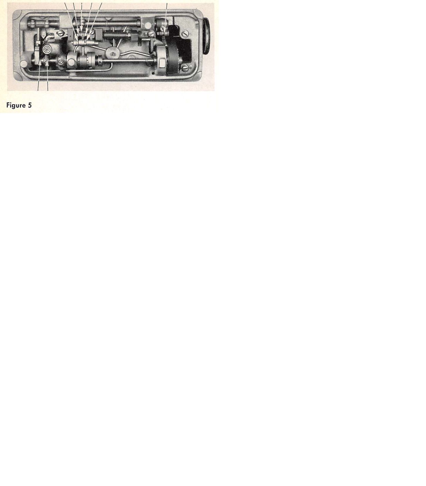

Tip your machine back and see if you have this adjustment underneath
If yours doesn't look like that then the adjustment will be on top where the main shaft connects to the reverse assembly. I will try to find illustrations on that style too
#14572
Sorry, got ahead of myself there. I should first ask if yoyr reverse stitches are longer than the forward? Helps to know that when you take length away from the reverse, it should inversely add it to forward length
