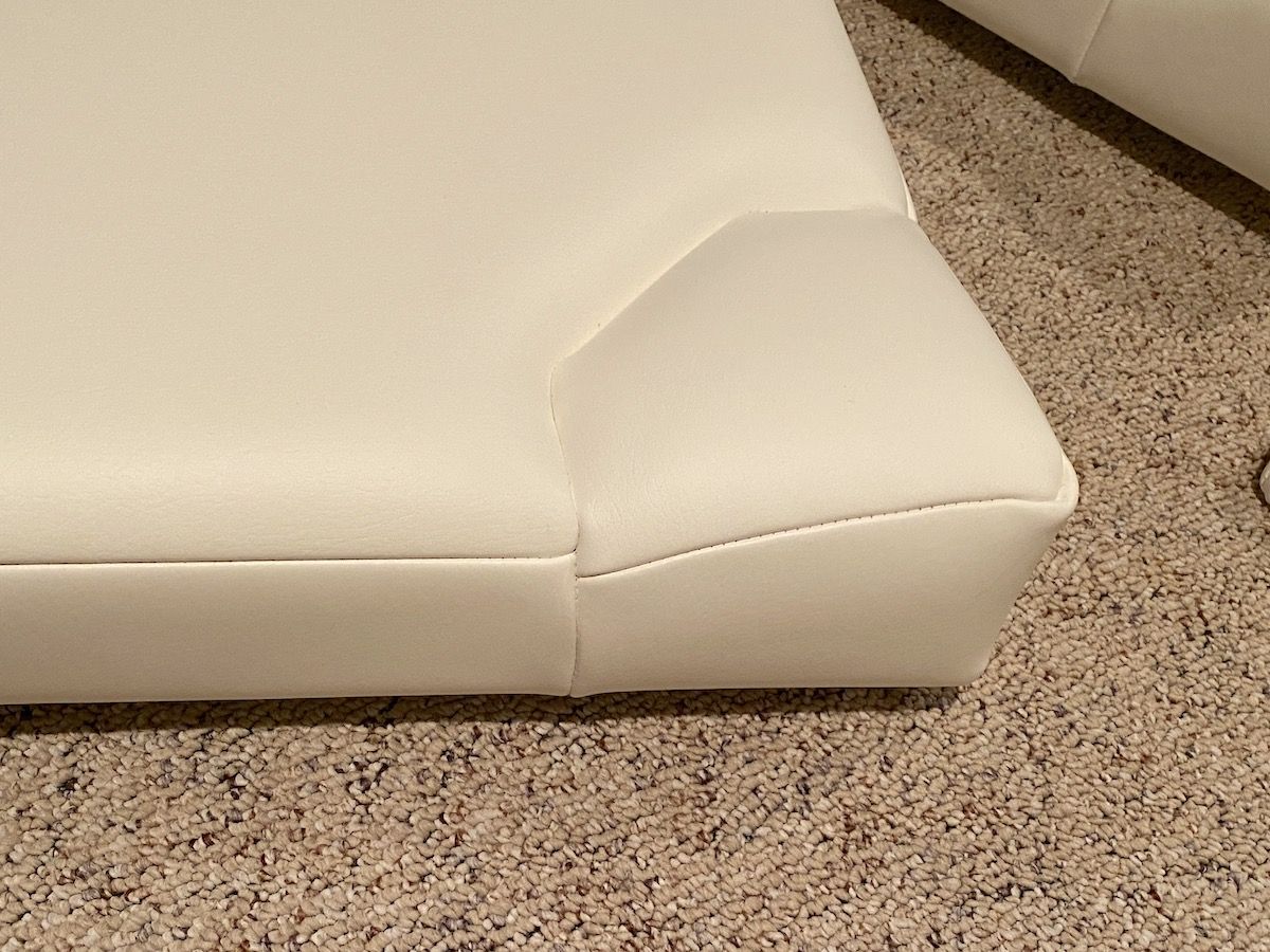

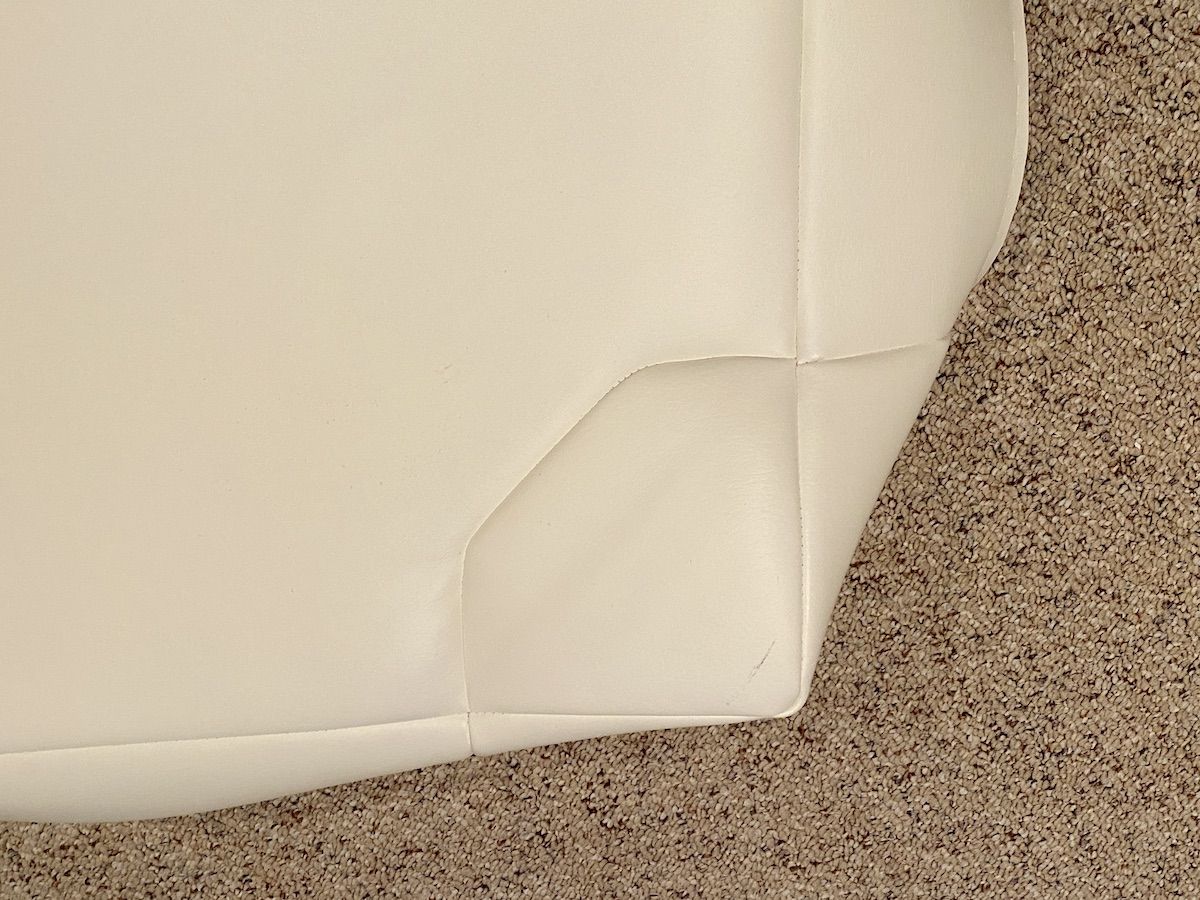

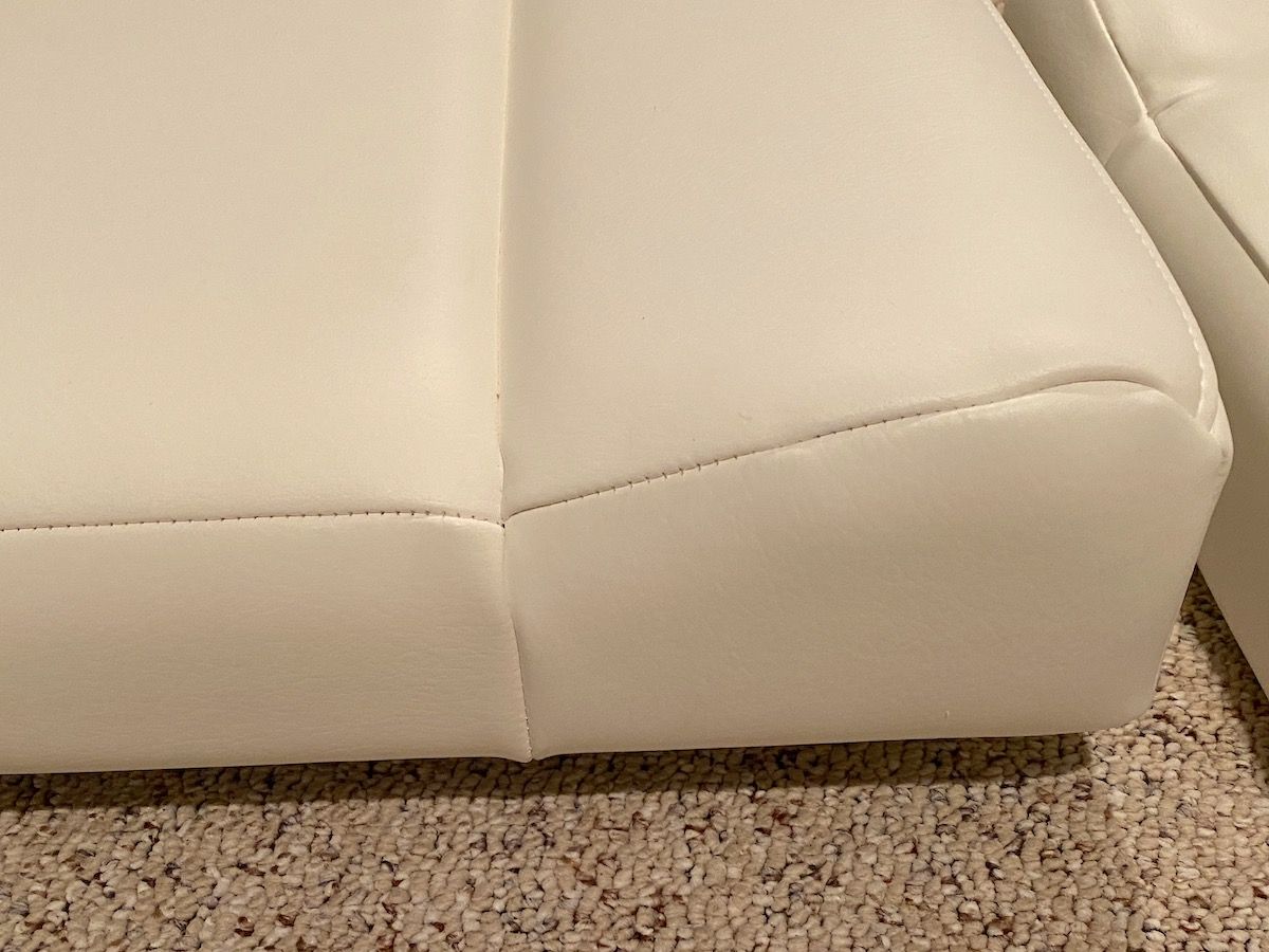

I am doing some boat seats (vinyl) that have intersecting seams on each side of the cushion. Proper alignment of the seam intersection is a challenge. I am wondering if there are any tricks to getting them perfect (or at least really good) every time?
My best bet may be to use basting tape to hold everything in alignment throughout the sewing. Here are few pictures of my hit and miss . . .
I can get them right with painstaking effort, just wondering if there are any proven techniques that folks have?
TIA for any help on this.
Pics below . . .
Pretty good . . .
OK . . .
Big miss . . .

I'm going to re-make the one that isn't aligned. I would like to get any pointers to avoid this sort of mishap going forward.

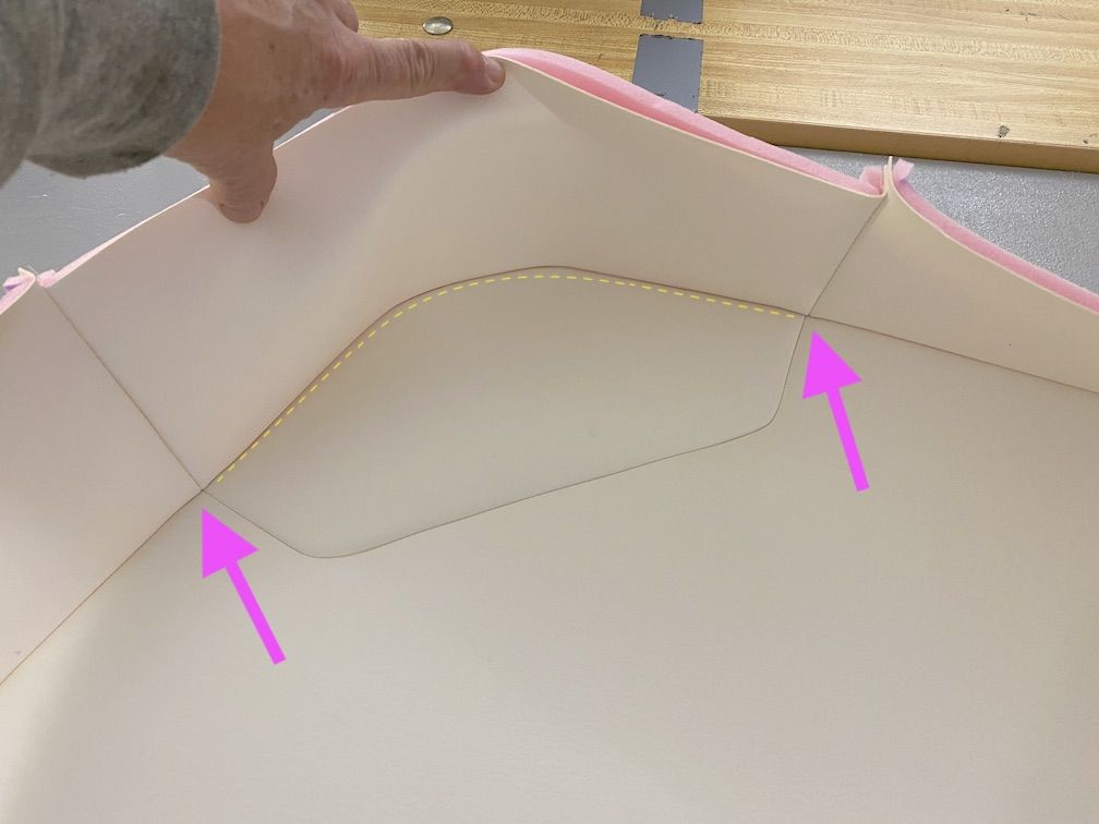

Quick Update . . .
I've got this intersecting alignment pretty well figured out. Here is my latest example . . .
I first check the critical dimension of the panels (yellow line) to see how exact they are.
I tack the two intersection points with a few stitches near the edge of the seam allowance to establish the alignment. (purple arrows) Then I adjust the sewing line (yellow), using more or less of the seam allowance as needed to get a proper fitting seam between the 2 intersecting points.
This is working out much better than merely following the alignment marks as I was doing before.
