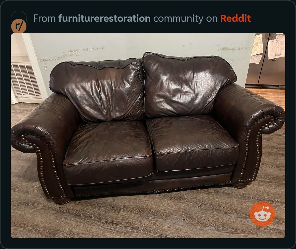

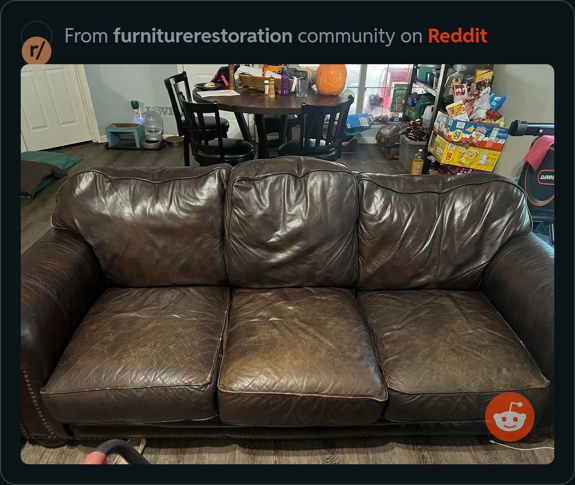

Hi guys, this is my first post here in this group. Me and my wife bought these a week ago from her coworker boyfriend for $200… it was to good to past up in my opinion. After we paid we lifted the couch up and mouse poop came running out like a casino win lol. Yeah yeah I know nasty but things can be cleaned and restored. We like that it’s leather wrapped all around it’s not vinyl like all the new stuff. This set has to be probably a good 15-20 years old it was in the family a while. we gave our 3 year old catnapper sofa set away for free that was topgrain leather(seated areas) but are shepard torn the vinly of on the side.
So far all I did was clean them and some leather honey. We ripped the black fabric off so we could get a good cleaning on the under side. We then noticed why it sage so much. Broken support board in the middle. Well you just can’t buy 1 inch thick lumber so i used my bench planer to get it to 1 inch thickness. So now that’s fixed.

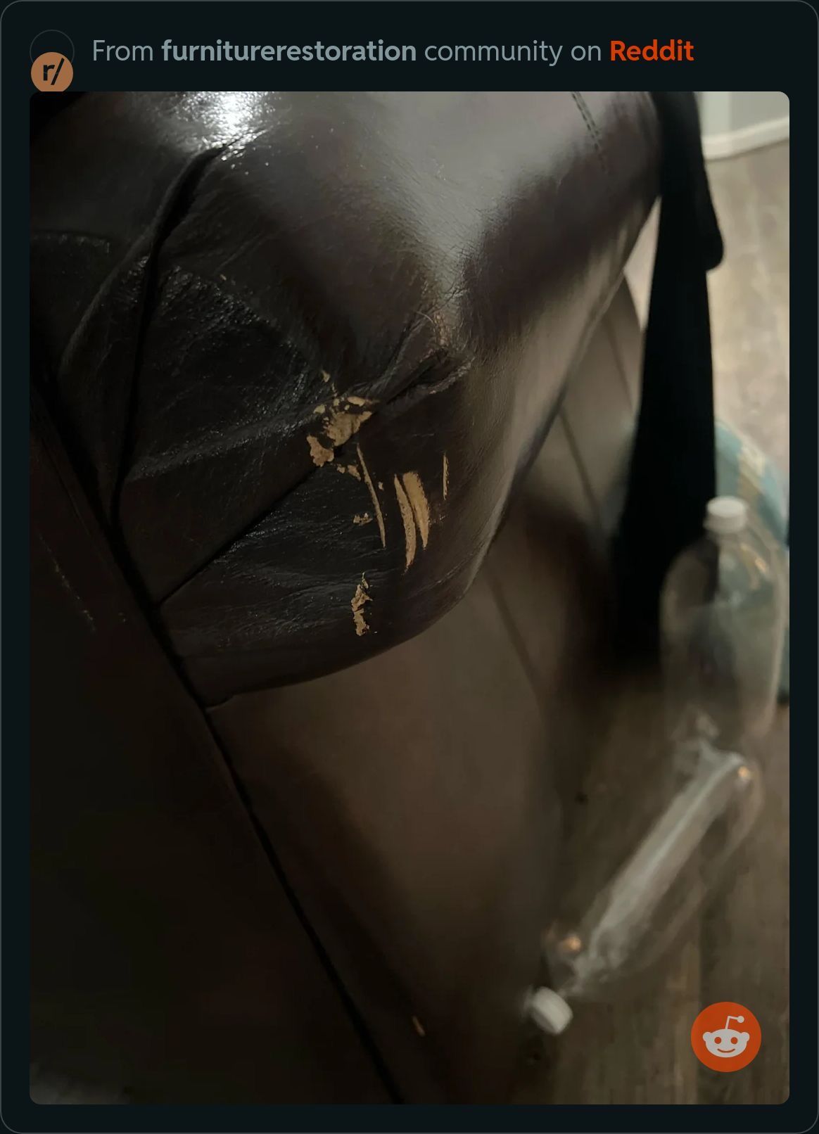

The first picture needs a repair before you can color it.
The second picture shows body oil so needs to be degrease before you can color is.
The third picture show the color layer being abraded down to raw leather, so you would want to degrease the whole surface. You will then need to prep the raw leather before you can color it.
Given the animals and kids you will want to go with a pigmented color instead of a stain based color.
