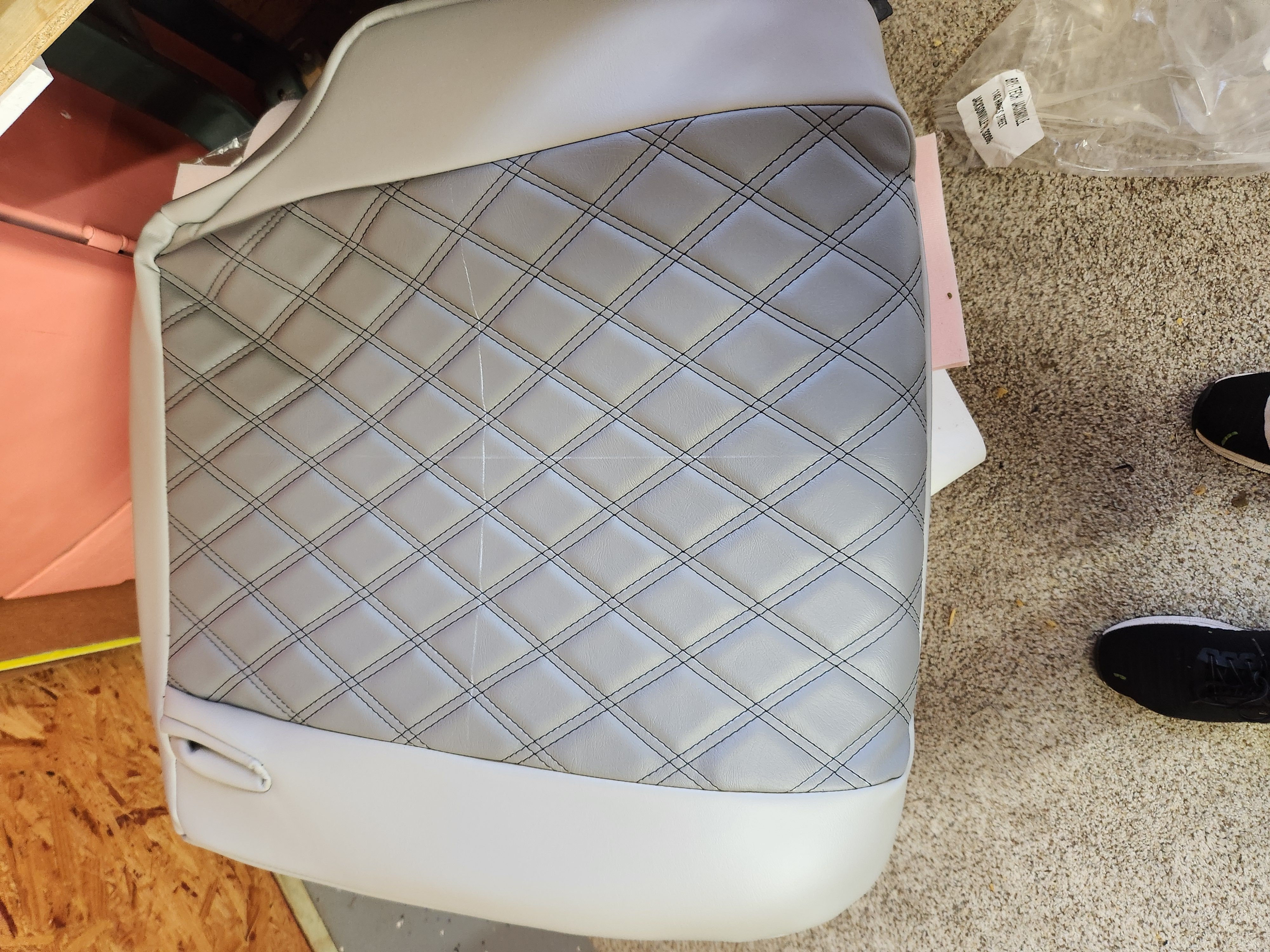

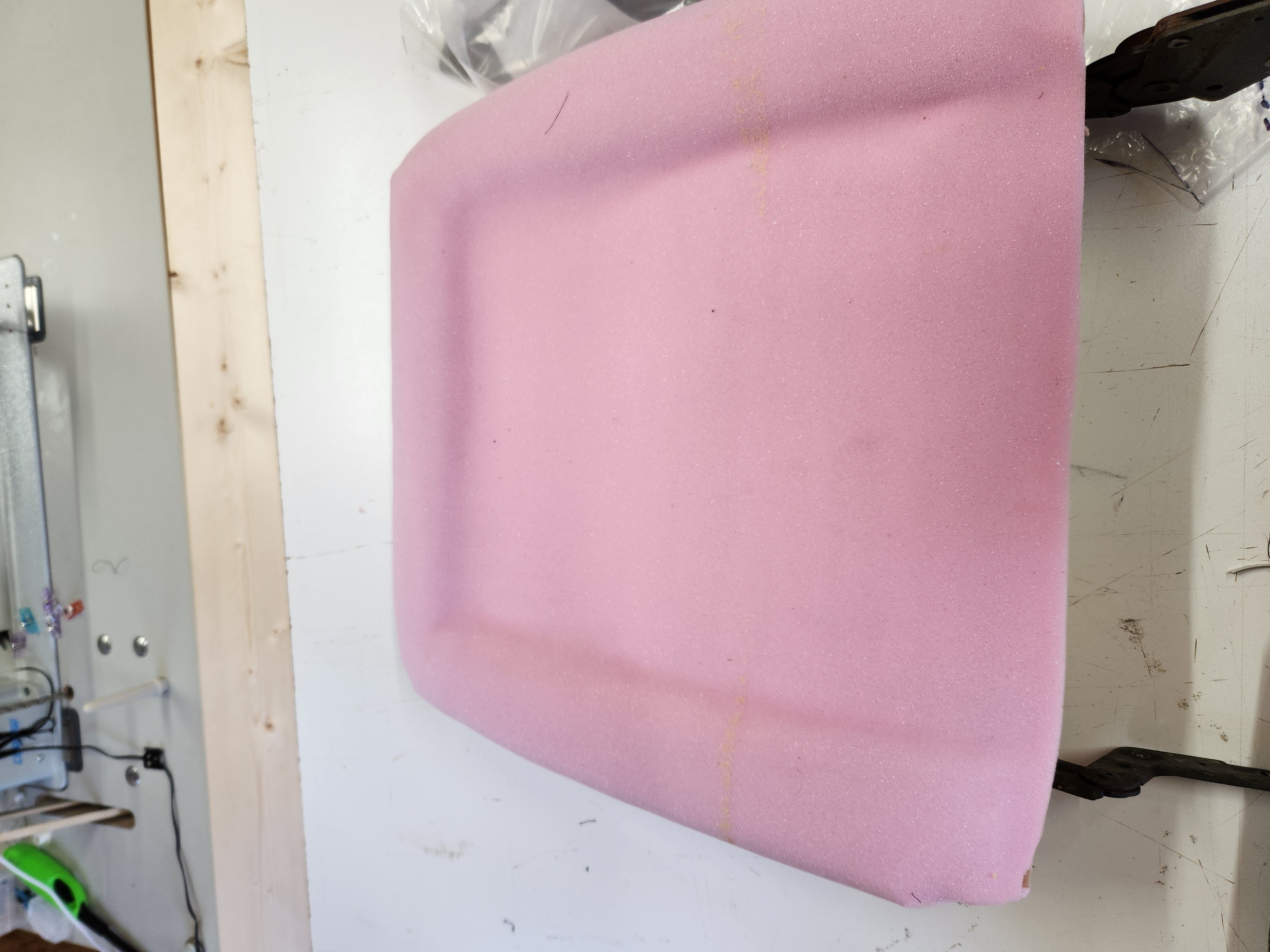

I sure hope after three years that I can still get some help on this subject. I am reupholstering a 93 chevy silverado and before researching more, ripped the covers off, shaved down the foam pleats and rebuilt the seat foam where needed. The new covers have double stitched diamond pattern on the insert. Here is where I need help. What would be the best way to secure the insert to the seat to get that nice tight look? Also is there a way to make it easier to get the cover on around all of the corners? Any and all advice is greatly appreciated.
#16859
@SusanW , you should have no problem getting the cover over the corners. If you are a novice and want to practice using contact cement between cover and your shaved foam this would work. If you set it wrong and the set time is long say 10 minutes you can pull and peel the cover off and reset. I am always trying to be aware that this may come back into my shop so if possible using listing would be an idea. I am assuming your covers are made already?
By SusanW
#16862
Thanks for the reply and great info. I have a couple follow up questions. I was thinking of using listing wire also however how do I secure it to the back of the foam? I think I need to put a thread through the foam and then some how secure it to the bottom of the foam. I have attached a picture of the cover that I made for the bottom of the seat and a picture of the rebuilt back of the seat. I guess I am just nervous to try anything because I have put so much time into the double diamond insert but I guess that is how I will learn.
