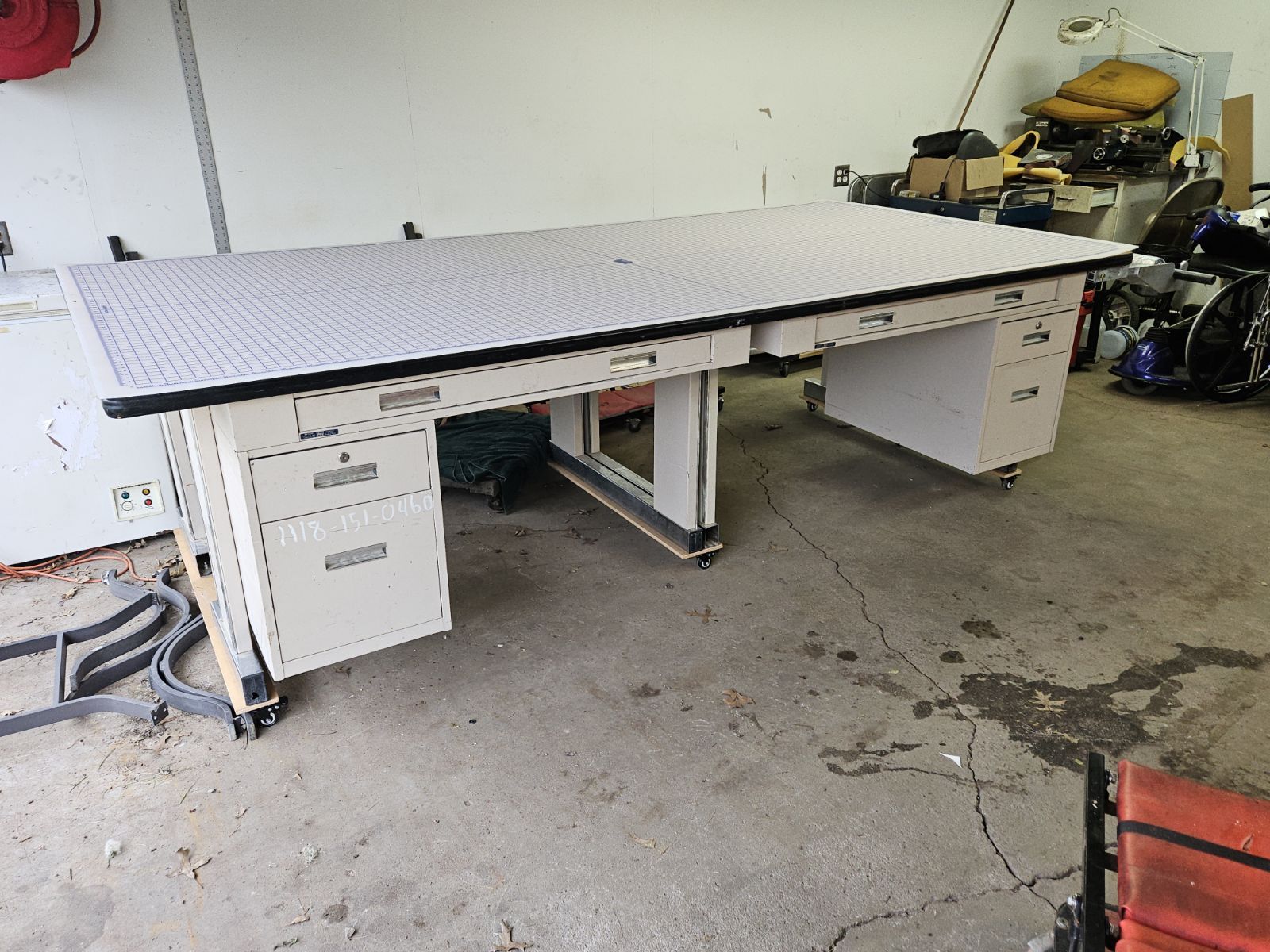

Now that I got it finished, I thought I'ld share my cutting/sewing table set up.
Sewing table 00005.jpg (327.25 KiB) Viewed 13264 times
This thing is a tank.. 5 foot by 10 foot and weighs over 500 lbs. :hushed: 1 1/2 ' solid top with 4 tanker desks as the base.

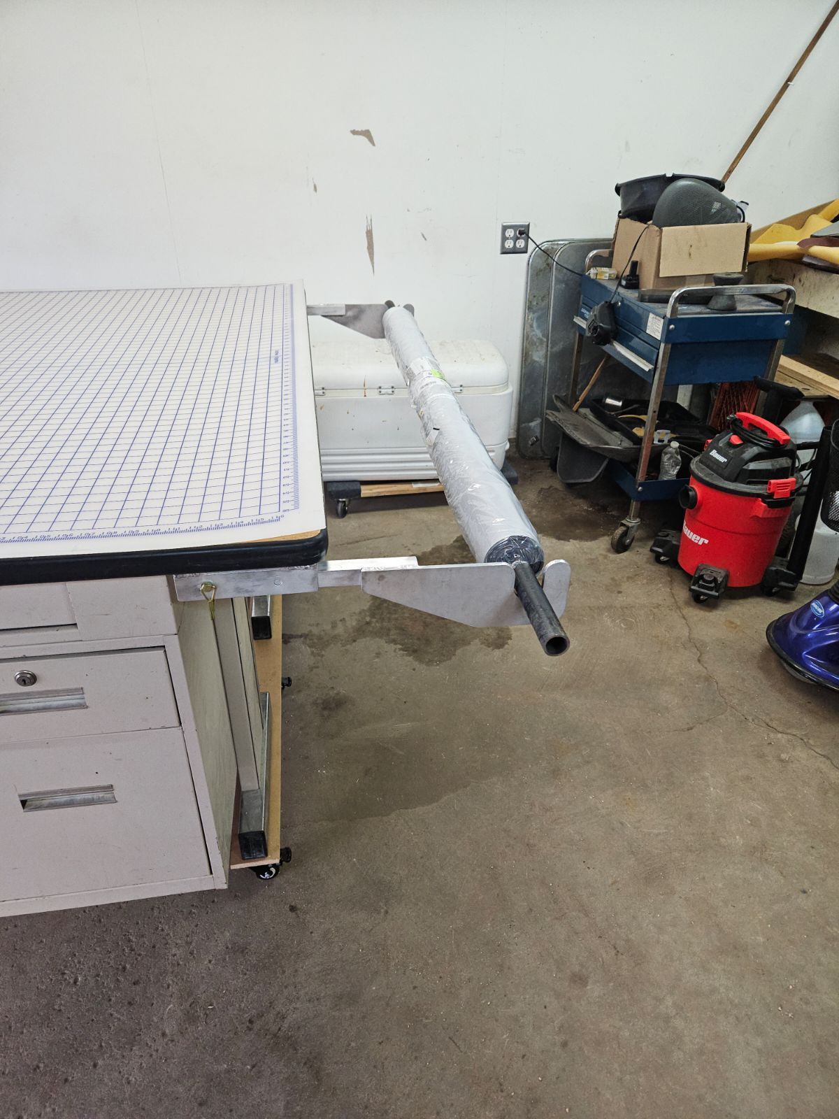

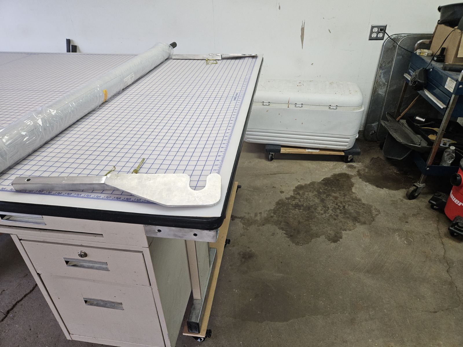

And here's the roll holder I came up with. Made from scraps of 6061 T6 I had laying around at work.
Sewing table 00006.jpg (257.37 KiB) Viewed 13264 times
I didn't quite get 60"s between the 2 as I did want the mounts to be completely under the table. As such, I wont be able to hold a 60" roll of canvas and my prior questions about diameter should be a non issue as it sit about 11"s from the center of the notch to the tables edge.
I also made it easily removable so I can have clear access around the table when I need to work.

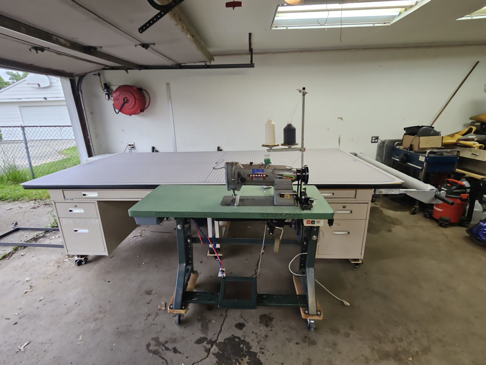

#16373
I placed it on casters and despite the weight it's pretty easy to move around. Casters are double locking if I need to lock it in place. Also set the machine table to the same height so I can place the two next to each other for more sewing support.
Sewing table 00007.jpg (185.75 KiB) Viewed 13263 times

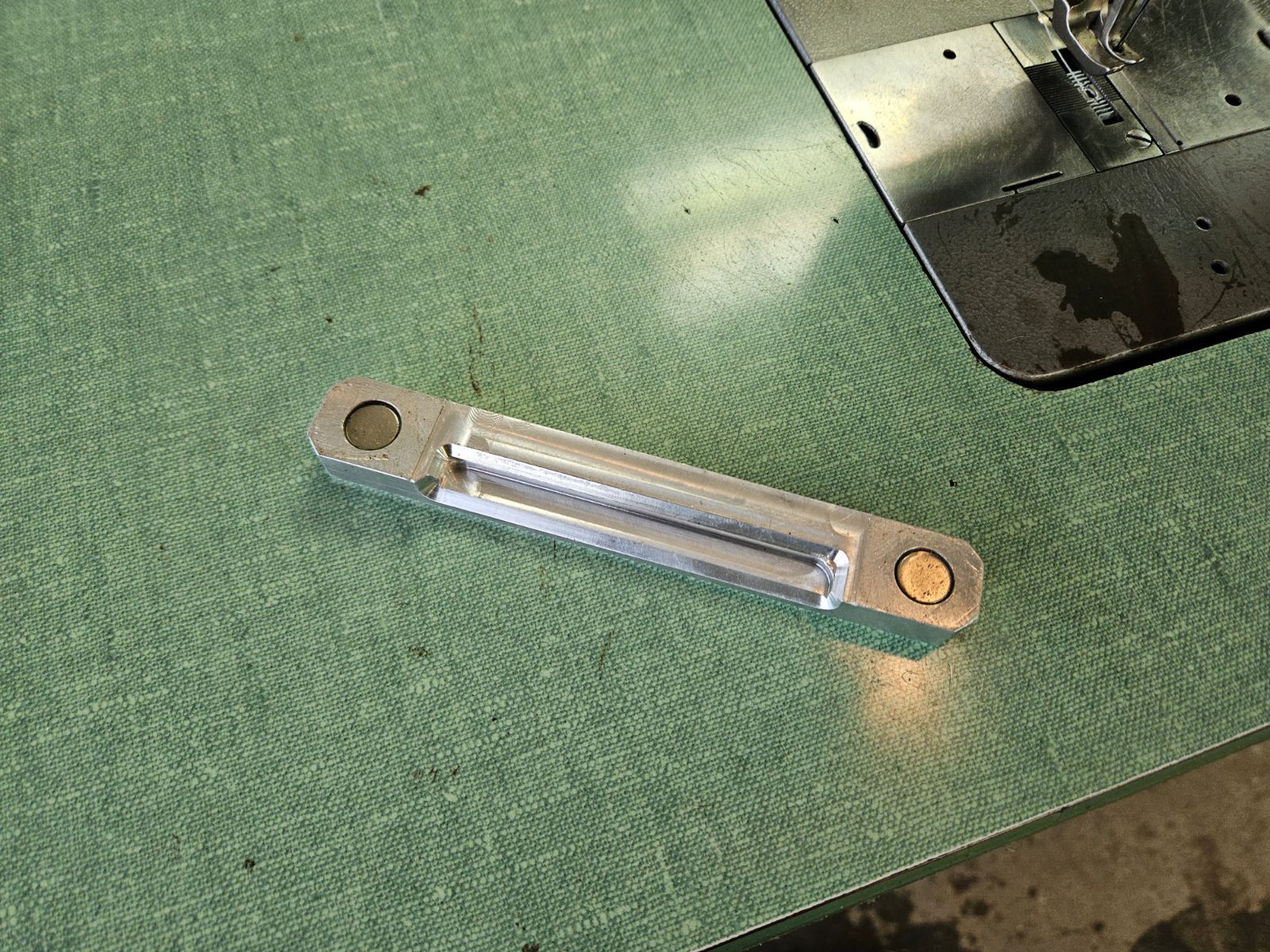

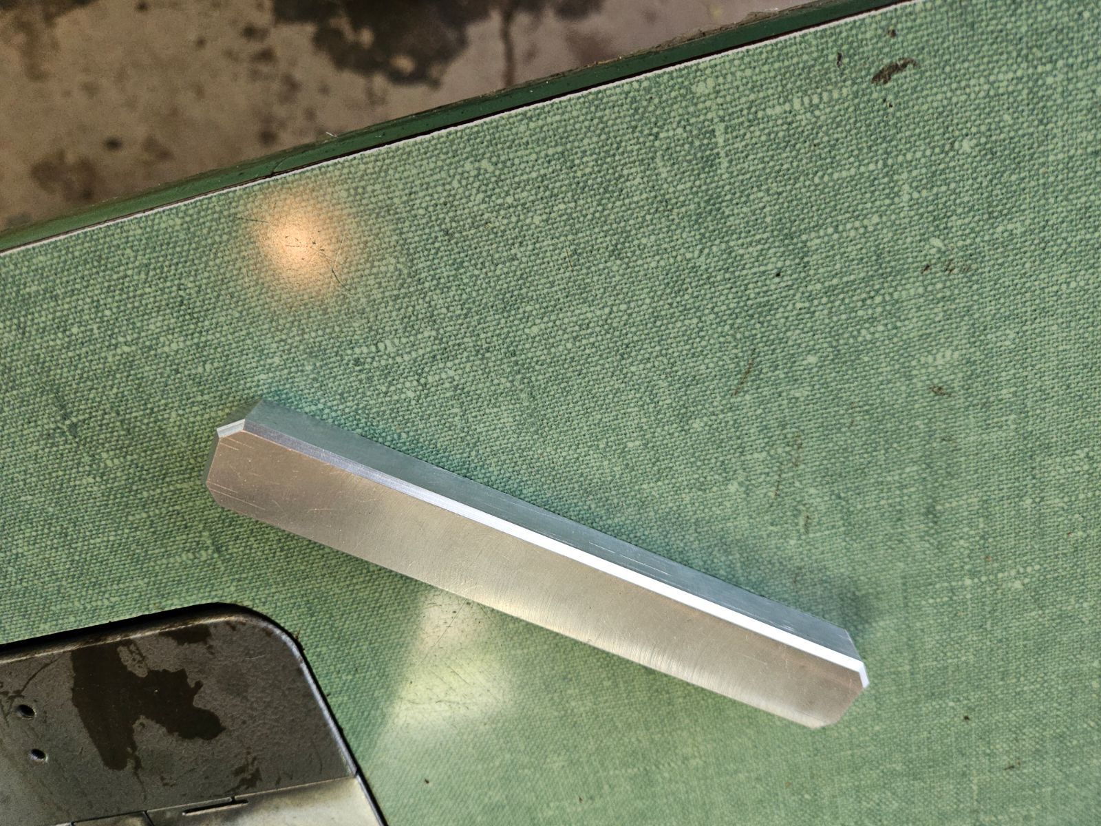

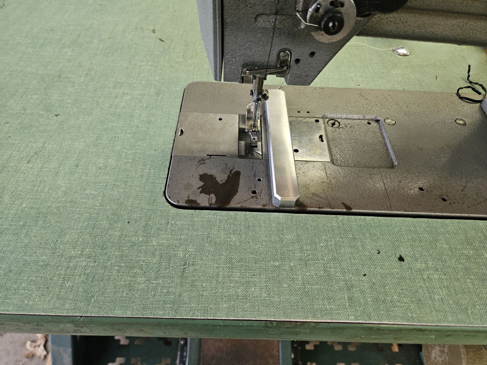

So out of another slab of 1/2' 6061 I whipped up my version of a magnetic sewing guide.
Sewing table 00003.jpg (410.79 KiB) Viewed 13263 times
One other small detail you might be able to see is the line I engraved in the bobbin cover that marks a 1/2" from the needle.
Sewing table 00002.jpg (471.77 KiB) Viewed 13263 times

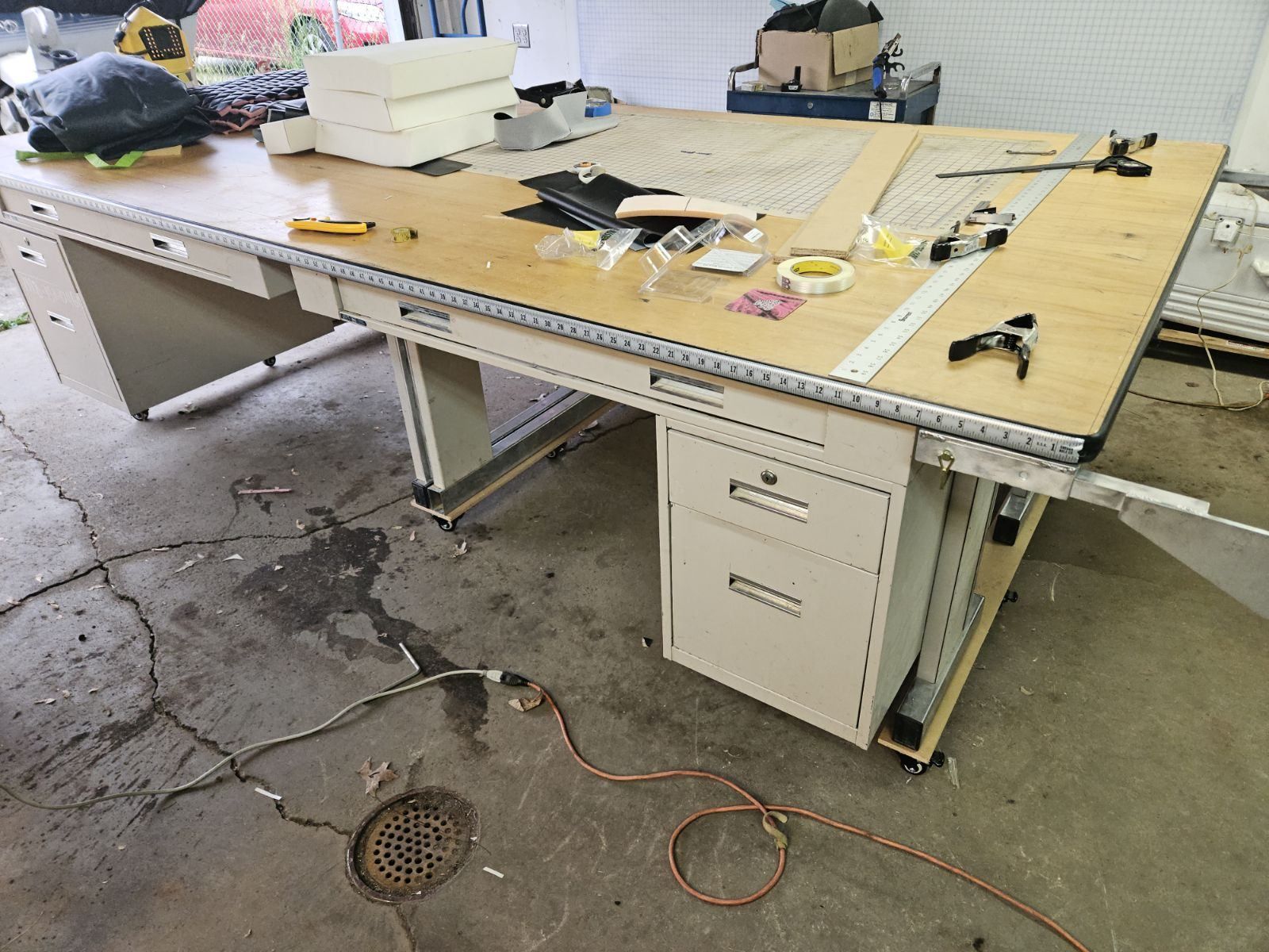

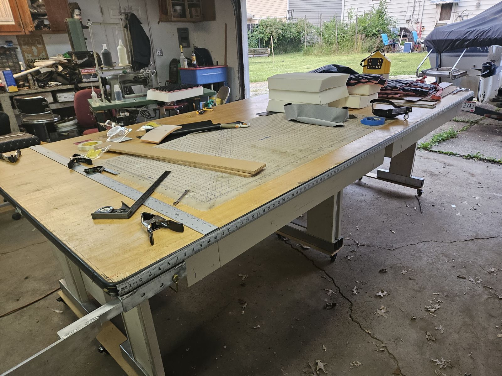

Slight upgrade made to the table today.
Added an adhesive measuring tape to each side. One reads R to L while the other side reads L to R so it's the same on either side when measuring from the roll down the length.
Sewing table 00008.jpg (367.76 KiB) Viewed 12969 times
Sewing table 00009.jpg (323.35 KiB) Viewed 12969 times

#16435
My plan is to use the side tapes to properly measure then clamp that 5' long ruler with those pony clamps on the table so I can have a nice straight edge to follow. The 5x10 cutting mat is great for material like vinyl wich is 54" wide. I can still see the numbers on the mat. However, the canvas I bought for making a cover for my boat is 60"s wide and while I can still use the mat to cut on, I can't see the numbers to line up the ruler. Hence why I went this route.
At least that's the theory :sweat_smile:
