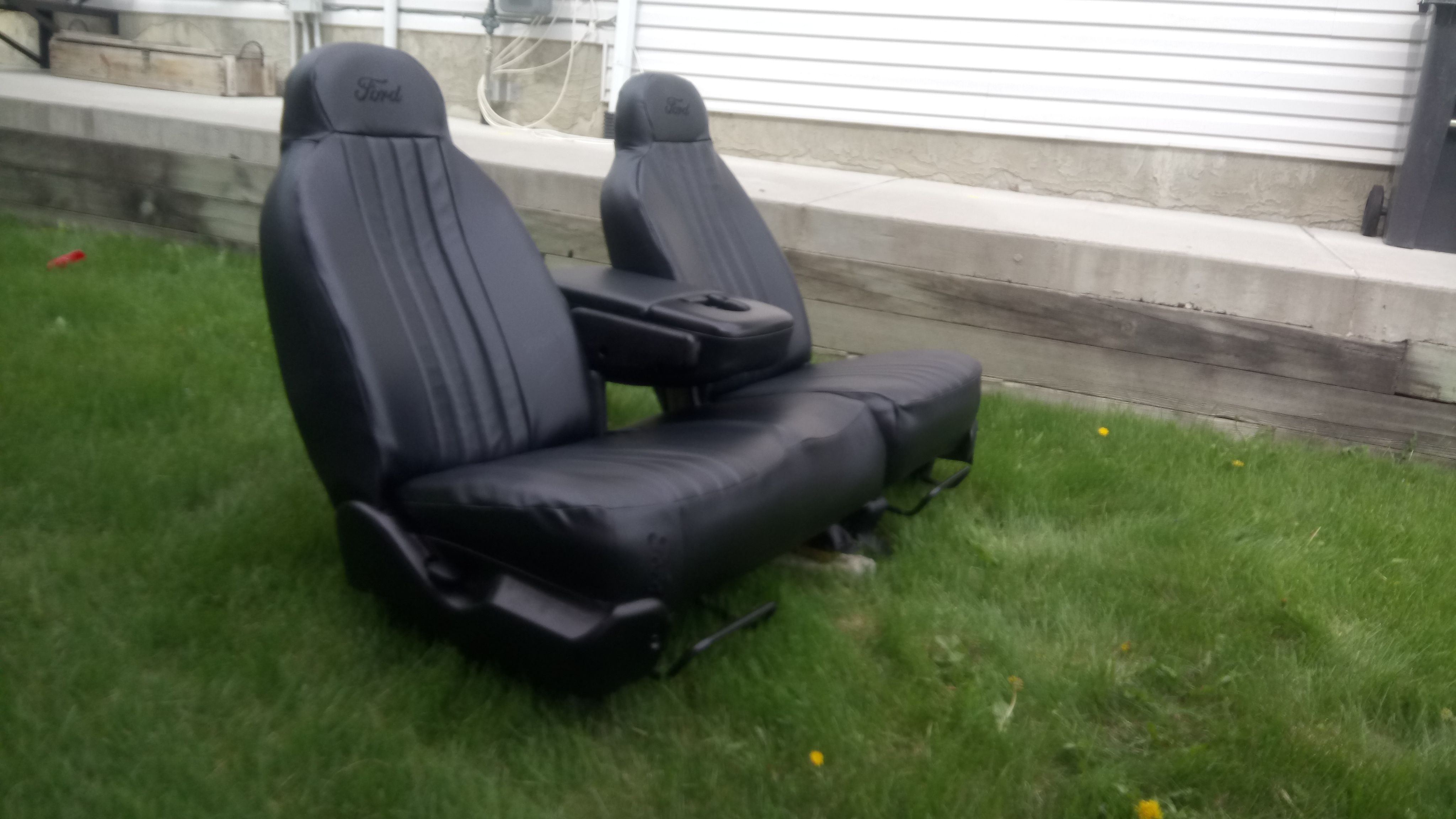

I am doing seats like these , my material is wrinkled after i sew it. is my tension to high or need longer stitch length,
its not been fun,

I could be totally wrong but is that lighter material cloth and the darker one leather/vinyl? If so, my thought would be that the cloth is moving as you sew it since it's softer. Just an idea from a newbie -

fibersport wrote: Sat May 31, 2025 12:56 pm I could be totally wrong but is that lighter material cloth and the darker one leather/vinyl? If so, my thought would be that the cloth is moving as you sew it since it's softer. Just an idea from a newbie -
This was my initial thought as well.

@Rhonda , We owned a Lightning and the material that was cloth was thin. I really do not like working with it. I even got that with vinyl on regular 10th gen F150 seats and vinyl. I would steam it down and see if it settles.

@BigRig yes sir I will be steaming. It’s not puckered as I sew. I was thinking maybe some kind of stabilizer. Like I use in embroidery. I have been experimenting this week. This is my boss , husbands seats. I need them to look good. The pattern is right the marks all line up. Once you put it on it looks like that. I thought the material might be wrong. I’ll keep working with it steam the hell out of it.

I really dislike working with fabrics and I mean a lot! The fabric pulls and tightens all the time. The seats are done and do not look bad.

Are you sure the fabric is not just gripping on the foam and not letting it smooth out?
Maybe try putting some silk film on the seat before sliding the cover on?

Could be. It can’t get no tighter. Marks all line up. Foam or 1/4 foam is not smoothing out

I had a lightning and the fabric stretched out pretty bad and rolled up. The vinyl looks pretty good on the seats, just fabric off.

Image :grinning: :grin: :rolling_eyes: :rolling_eyes: I never want use that fabric again. The seats are picked up and gone. They were happy with it.
I can’t believe it but I did heat some of the wrinkles out. I think it will get better with heat and someone just setting In it.
