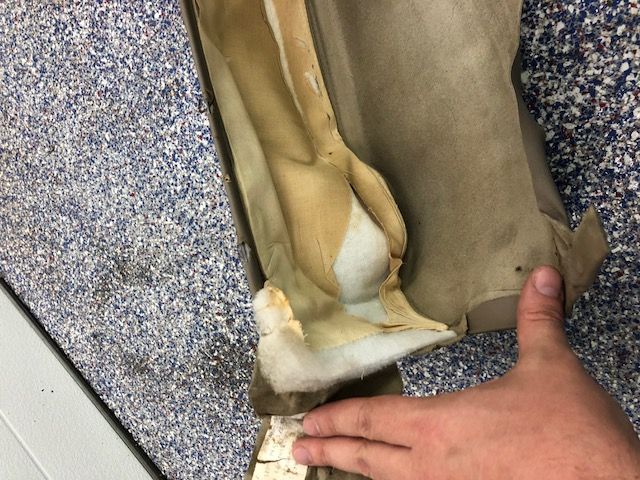

Se attached pic of padding. Hard to tell but it's one side bolster. They don't have any padding on side but they do have batting and fabric (ripped) on seating area. I'm just trying to understand WHY they did it like this. Was it just era thing or there is something different about batting vs foam.
Foam: Yes, I saw lot of videos where it's suggested to not glue. Just little tack glue and then secondary seam around perimiter to hold foam. This is, of course, unless you do diamonds, etc.
Heating: Those seats already have heating, so I just need to reinstall it back. Disregard question, it was my brain fart. Heating pad goes between batting and seat foam. No between leather and batting. So, it's all good here.
BTW, those heaters is wire, no fiber. It's a thin wire embedded between 2 fabric layers. And I fixed some of those before. You just find burnt spot, re-solder wire, cover it and it works again :)

@IvanD i don’t know I’m just taking a guess but saying it was an era thing. I would think a sew foam replacement would work just fine. Unless you’re wanting original or close too.

Cody wrote:@IvanD i don’t know I’m just taking a guess but saying it was an era thing. I would think a sew foam replacement would work just fine. Unless you’re wanting original or close too.
Today noone will be able to tell what "original" is :smiley:
I am thinking from at least looking at videos/etc - scrim foam will be much easier to do that batting like it is on original.
I'm going slightly different design (with ultrasuede) so no originality will be there..
This was more curiosity thing.

BMW seating has really been puzzzling to me. I have seen some seriously different ways they build their seats, the scrim foam tends to be different than some other manufactures and in some cases have found rubber mat type material in the seat. Where are you from? Are you sure you want to dig into those seats right away?
