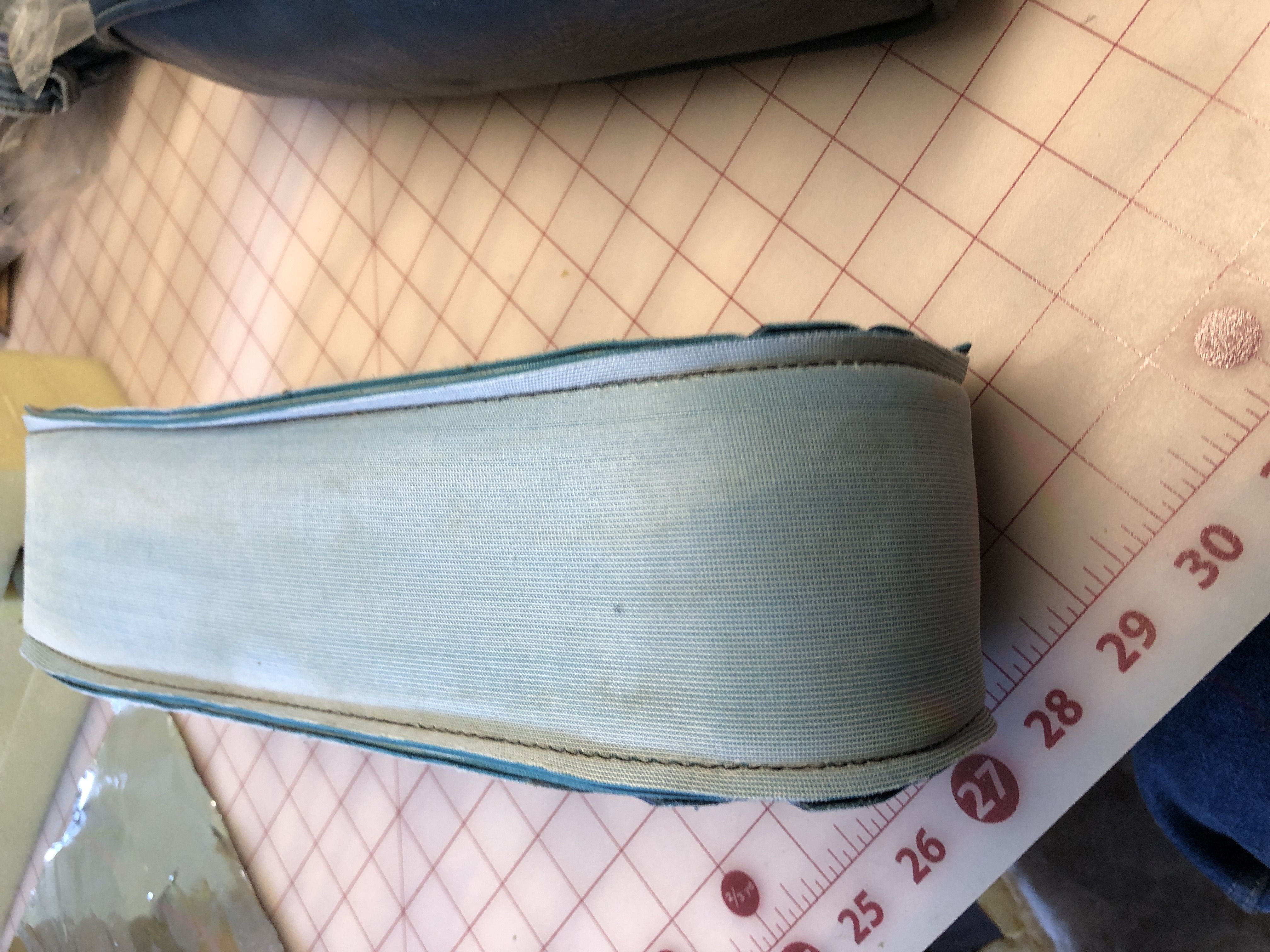

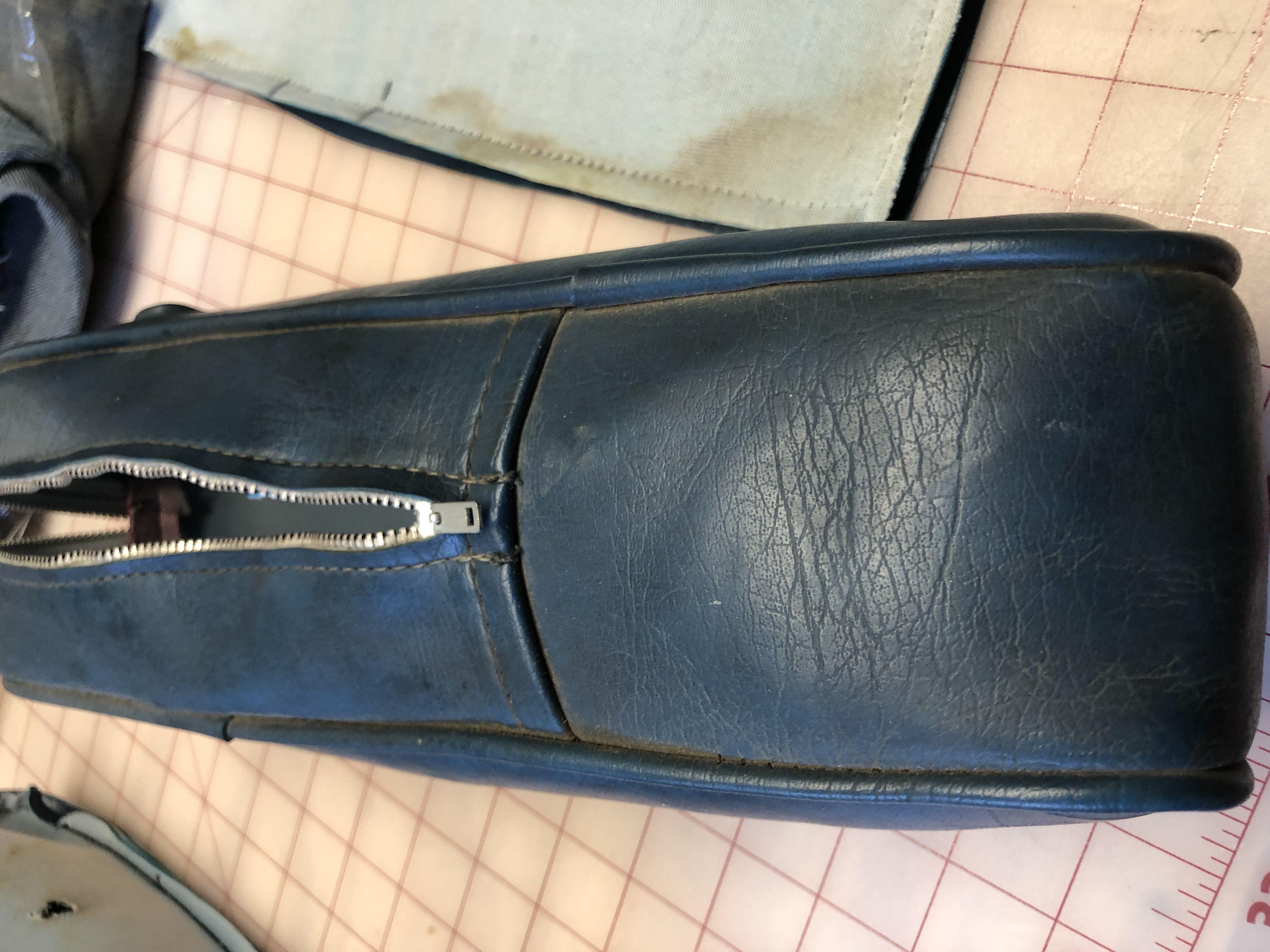

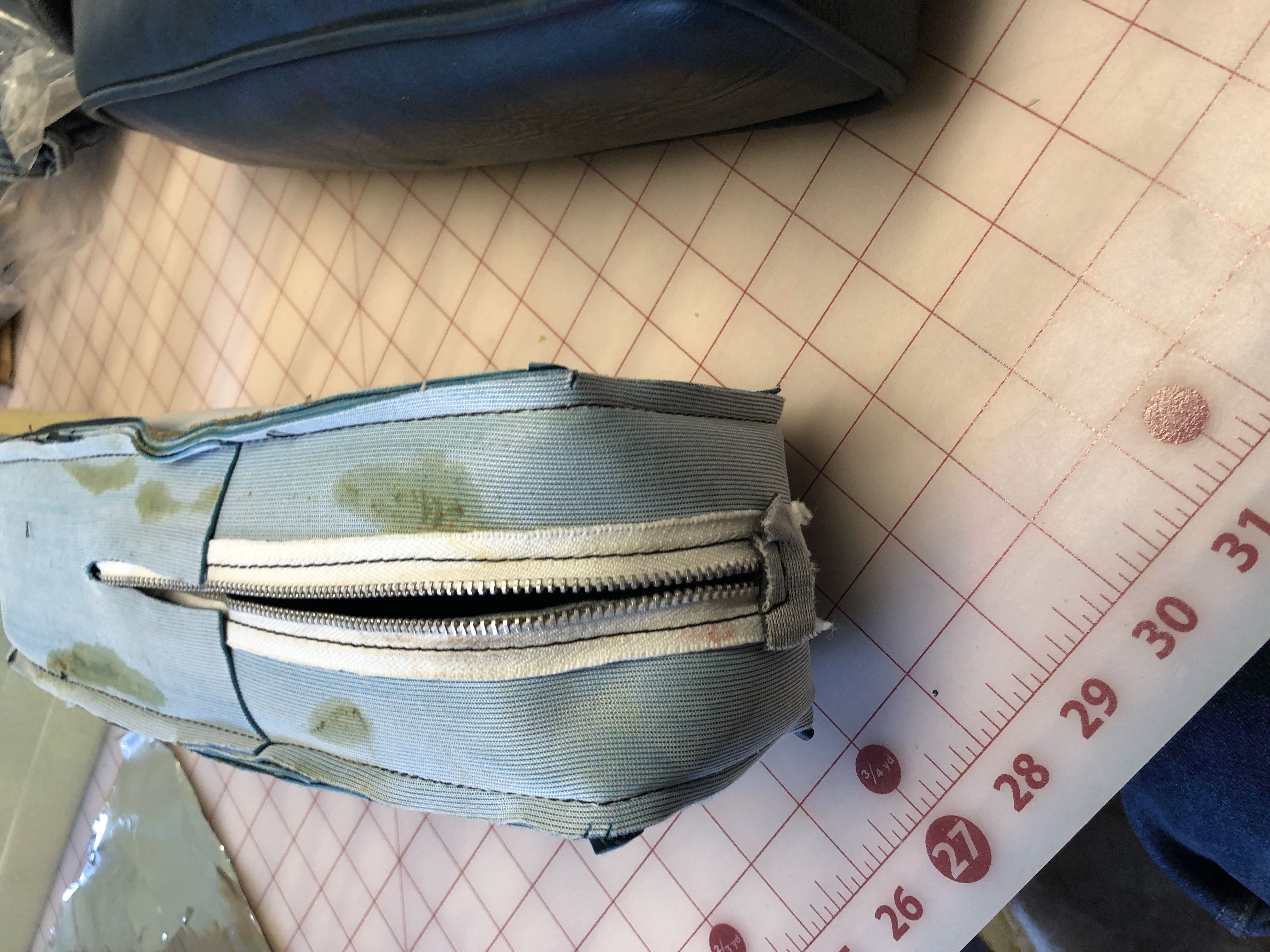

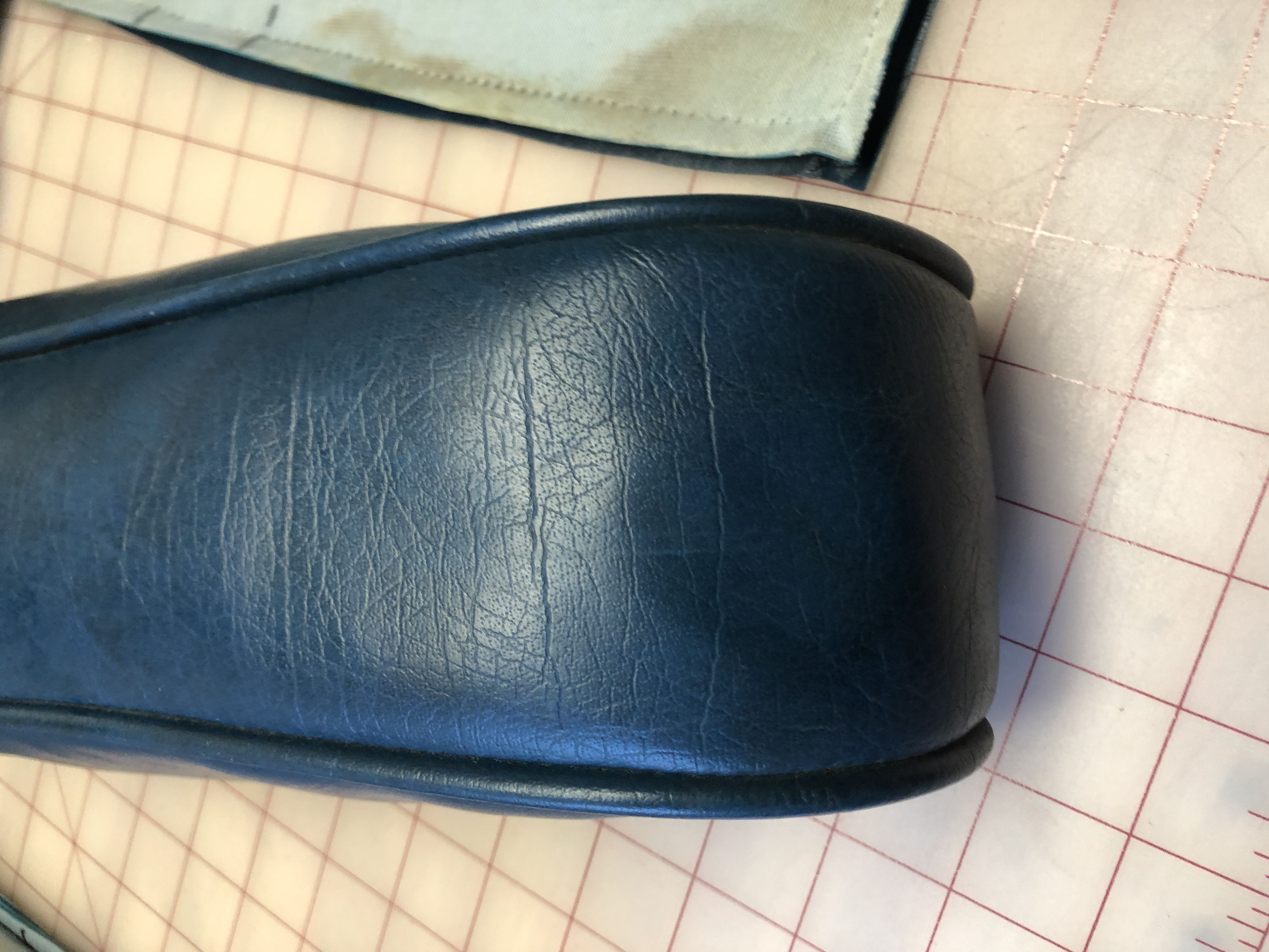

Is it possible to change a fully enclosed armrest from edge bead to top stitch? I just simulating sew this but it seems like due to the geometry that it get hung up on the machine. I know that newer armrest are only half upholstery and half shell, so topstitching is no issue.
#15498
@JimmieJoe , you sure can same seam allowance and everything just top stitch it up and NOT if you want a classic look.
