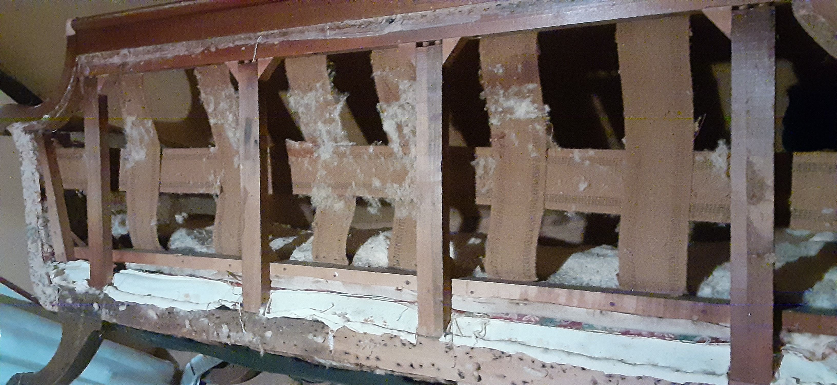

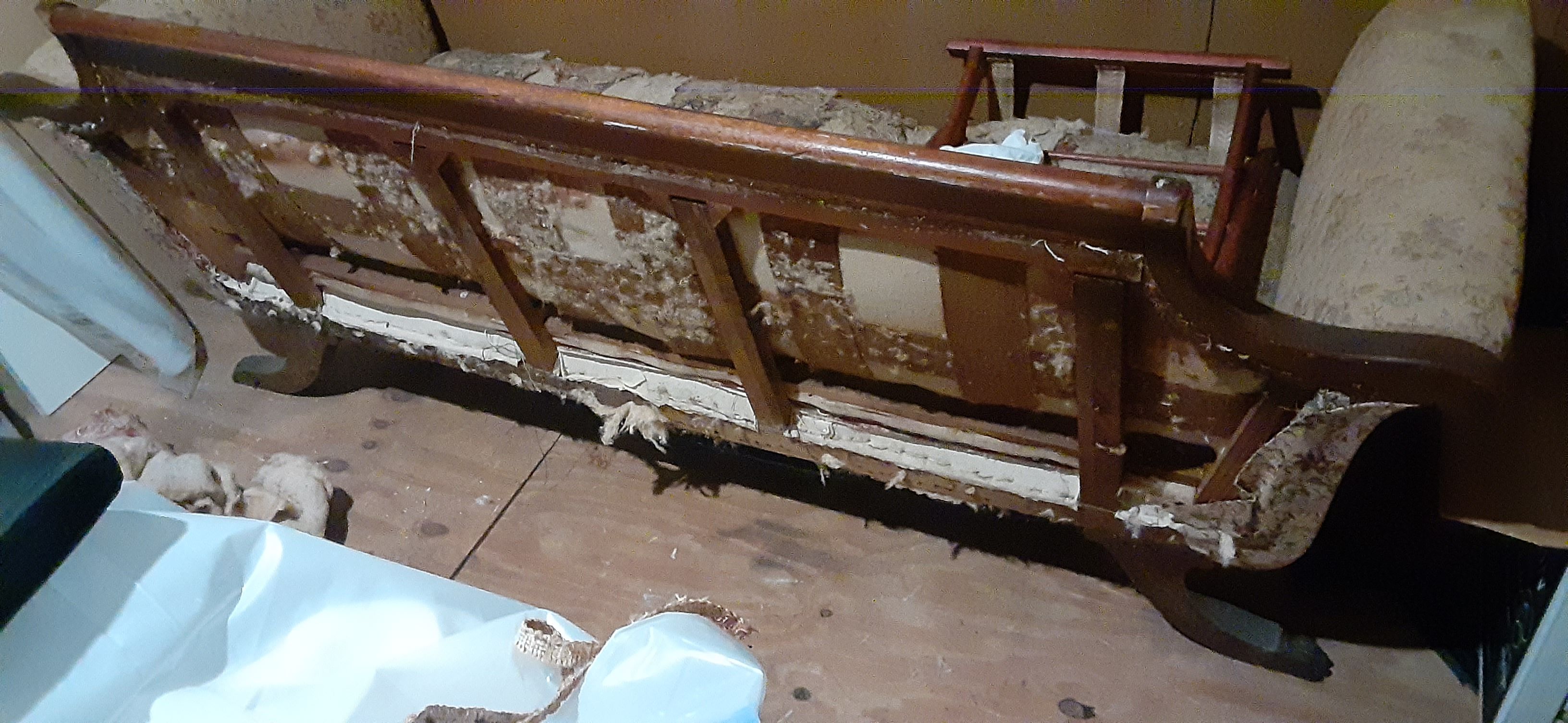

Have taken on the project of my grandmother's Duncan Phyfe sofa! It has been with me for 40 years, and has had a lot of abuse, and I figured it was time to breathe some new life into it. I have sewing knowledge and have reupholstered dining room chairs before, but this is my first attempt at hand tying springs, strapping webbing, etc...... Will hopefully post pics as I go.
I have completely deconstructed the sofa, saving the fabric as a pattern, and saving the horsehair padding to reuse (will clean it first),

The holes I was concerned about filling are the ones that are hidden, where the tacks and staples for the webbing, spring tying, horsehair and cotton padding attach. Have been washing, reshaping and getting the horsehair ready for reuse and will start the wood refinishing probably tomorrow. The exterior visible frame is in pretty good condition, just a few light scratches that should come out with a light sanding. Saw Gorilla wood filler that says you can nail and screw into it when it was dry, and thought I might give that a try, since the holes will be hidden.
