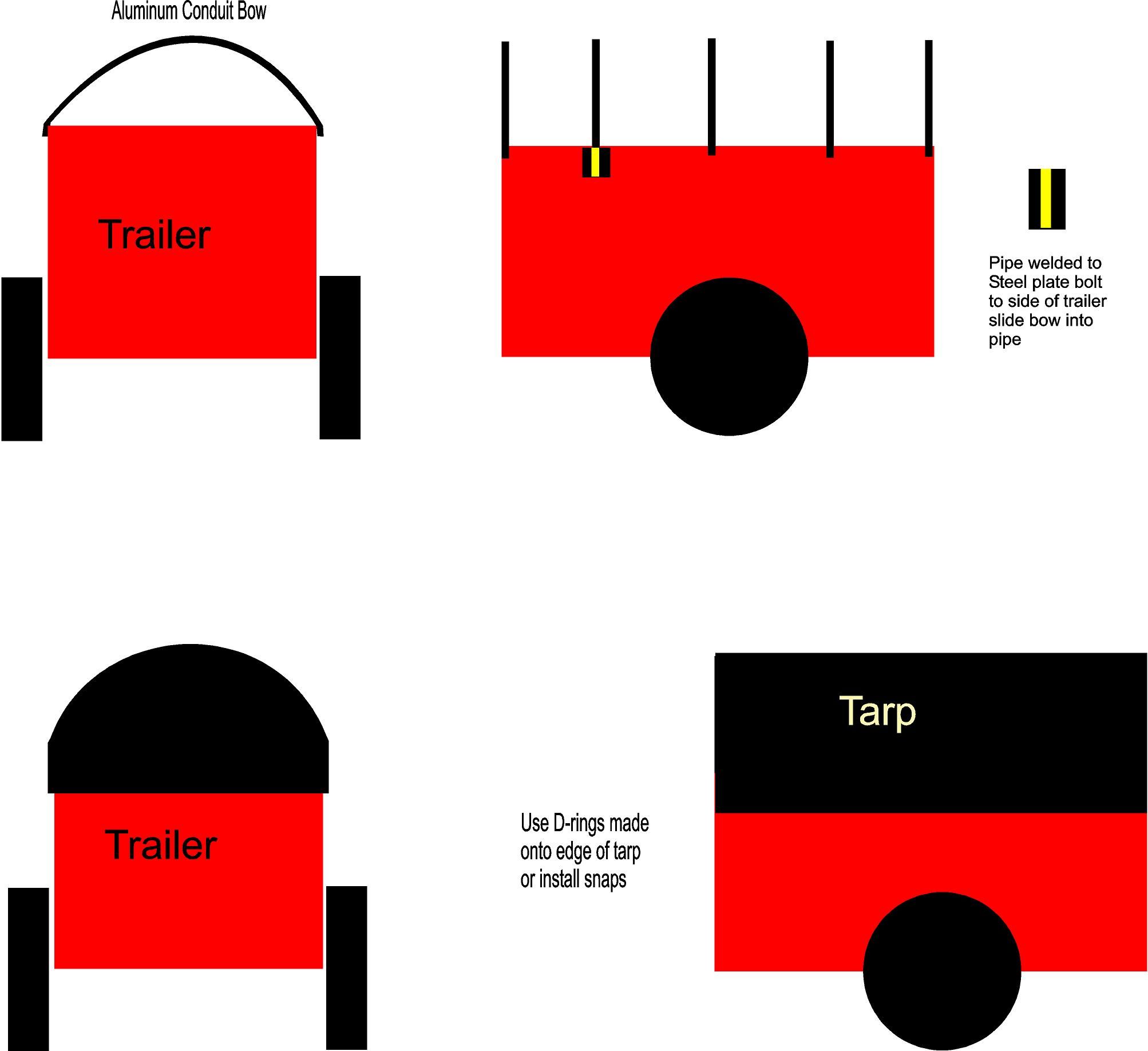

I'm going to make a sewn PVC cover with grommets and bungee for my box trailer that gets towed behind the car. Think you call it a utility trailer in the US. Main question: pros cons of various techniques:
  • panel on top with a hemmed box section for sides?
  • flat single sheet type
  • single sheet with folded corners type
  • any other types?
Thanks folks. I'd probably be happy with a single sheet with the corners folded back in neatly - how?
How do you stop abrasion on the inside corners?
If it's panel and box type how do you seam for water tight?
Lots of questions :wink:
Any tips? Suggestions? Patterns? Pics?
Cheers. (here's a table top pic playing around with folds)Image
#559
I think I would go with a flat sheet and reinforce the corners, this way you can always use that for something else. In would just put a piece of foam under the corners of the box if there is too much pressure on the fabric from the trailer once it is strapped down. If your cargo changes then your cover will not be as versatile if it is customized or fixed to a particular dimension.
I am looking at doing a cover right now and after pulling my gazeebo cover on for the fourth year in a row the fabric is taking a lot of stress at the corners so make sure your lock stitched there.
#570
I'm not quite sure I understand. But I would go with what ever design is easier for you to put on and take off.
As far as water proofing seams. I think you be surprised how water resistant just a regular seam is. Test it yourself. Sew up a small bag and fill it with water and see if it leaks.
If you want to really make it extra water proof you can use this stuff. HH-66 vinyl fabric cement. https://amzn.to/2KYVCyb
You can brush it on your seams before or after you sew.
For high rub areas I sew a layer of heavy black vinyl to the inside of the cover.
