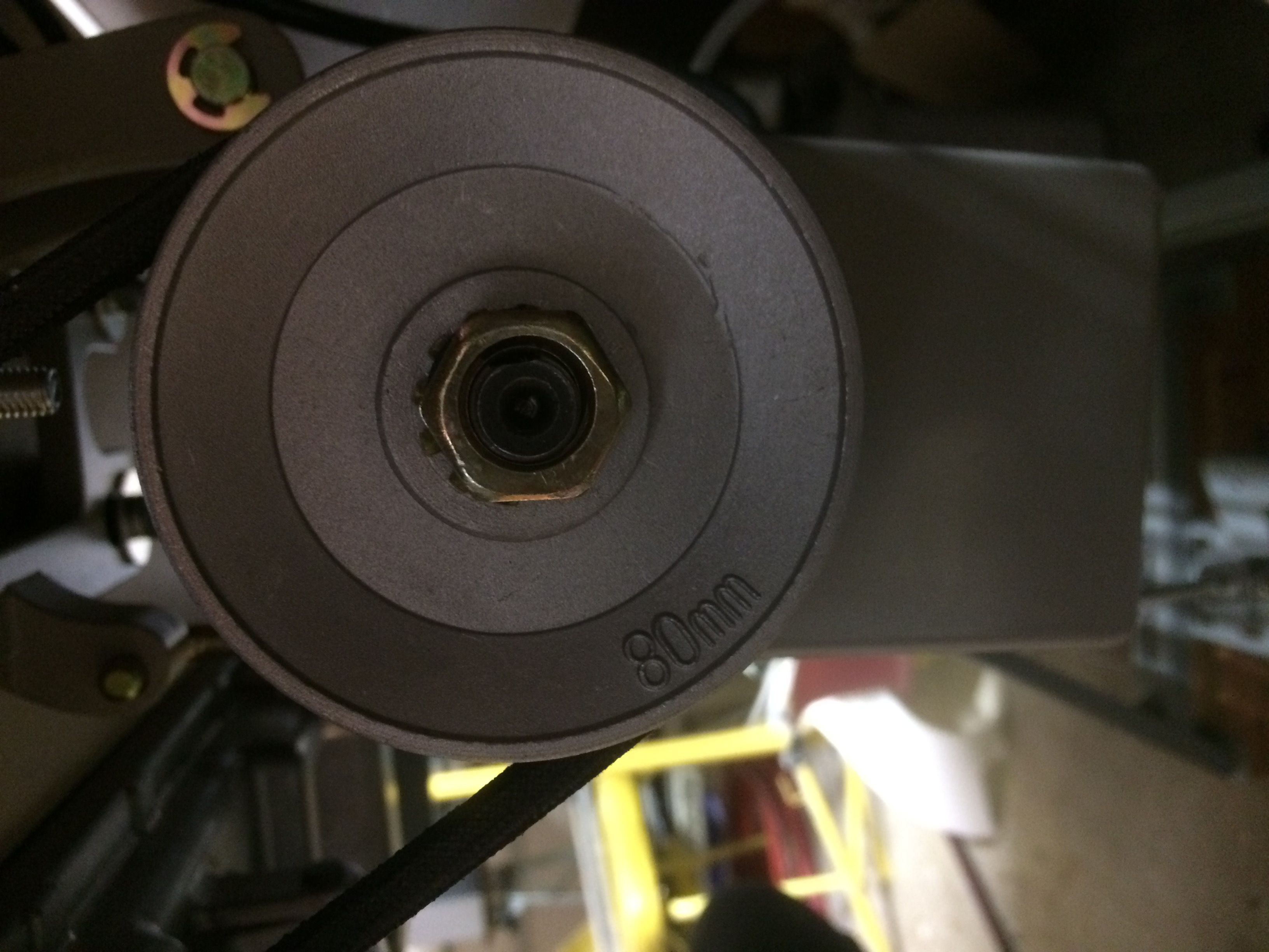

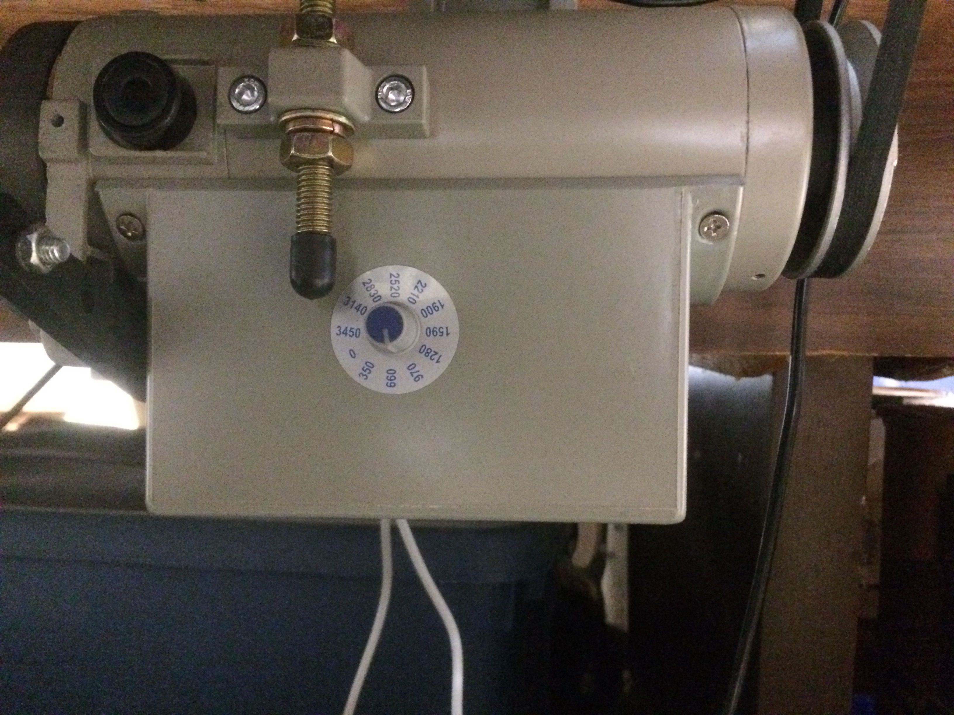

By SmokinSCustoms
#764
@John
If you slow it down below 660 it won't even turn the machine through. I can't find the specific specs on the motor or in my paperwork, also most of its in Chinese which doesn't help me much. The machine model is a DU-1181N.
It is definitely frustrating, its a servo motor that wants to act like a clutch motor. Extremely touchy.
#767
@SmokinSCustoms
If you are looking to change motors, go to Sailrite.com, their Workhorse servo motor is supposed the best you can get your hands on. That's their words not mine, but I do have this motor and it is unbelievably controllable and strong.
#776
@SmokinSCustoms Thats really strange.... On most servo motors I have used, when you set it to the lowest setting it wont move like your saying but as soon as you turn it up a few clicks it has plenty of power and is easily controllable. And the motor you have looks like most of the other servo motors Ive used. It shouldn't act like that.
You recently bought this machine new right? Have you called the place you bought it from yet?
@Bondo497 Yeah they are defiantly strong ans super powerful. I was impressed with it. Especially cuz it feels like a tiny light little motor when you take it out of the box.
By SmokinSCustoms
#793
@John I haven't got in touch with them yet. Was trying to troubleshoot the problem that way I when I talked to them I'd be a bit more knowledgeable. I'll give them a call and explain the issues and see if they have any ideas. Maybe just a smaller pulley swap might do the trick? This machine can run WAY faster than I would ever want to sew. I don't know who would want to lay down 2,000 stitches a minute.
