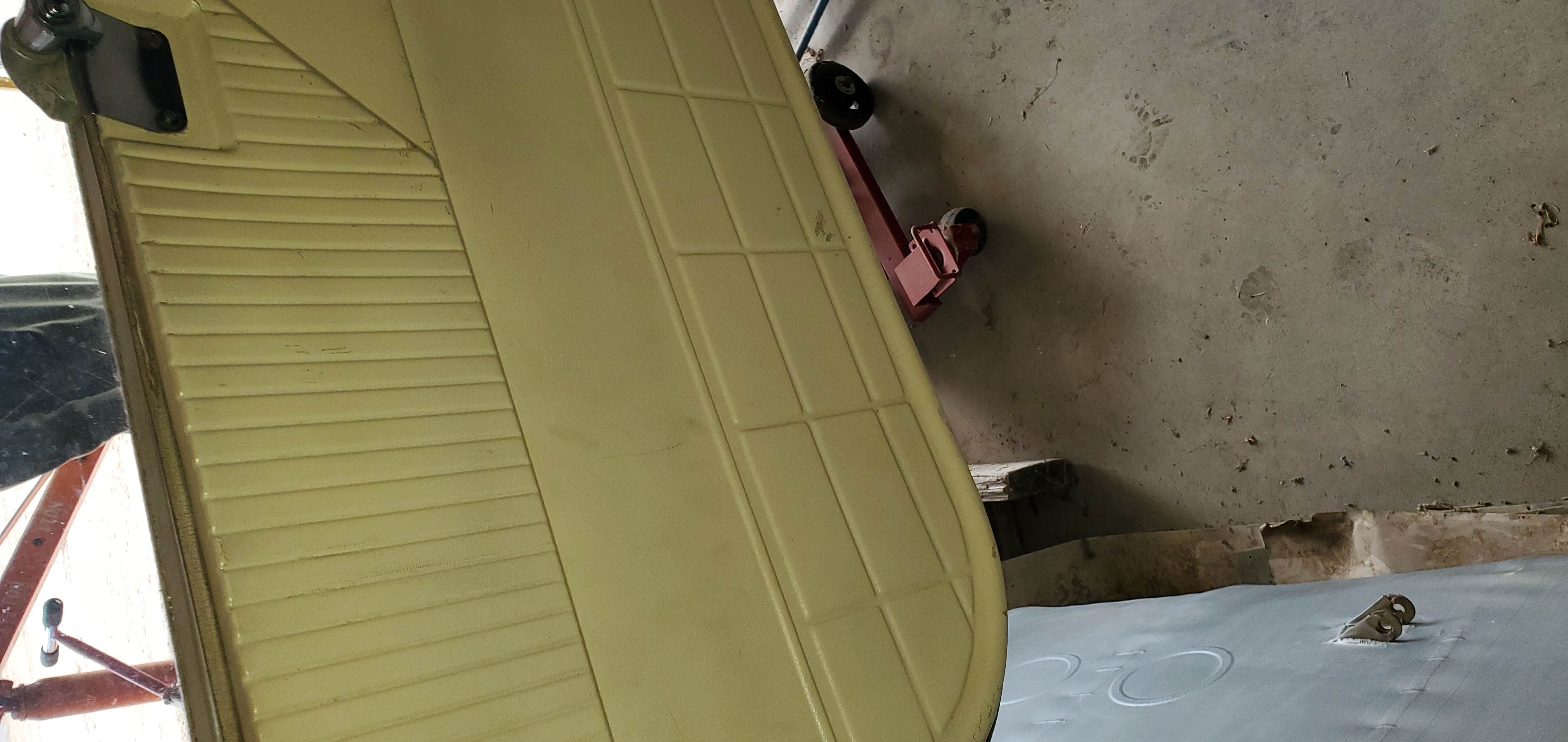

I am looking for ideas to clean up or update the look of some Cessna door panels. For those who have had experience with SEM Color Coat; is it durable enough to be used on a interior door panel?
The current color is white and I plan to change to tan.
I also have the interior panels to do.

Thanks, I sent to SEM asking a few questions about repairs to thin plastic panels. The more I look at these panels I am trying to visualize putting a sidewall fabric or carpet on the lower part where the rectangles are, this area gets kicked and scuffed up when people climb in and out. I could fabricate aluminum trim pieces to tie it in visually.
#22643
I would put the carpet on the door panels. No matter what that paint will scratch and look like hell over time and it wont take long.

BigRig wrote: Mon Feb 16, 2026 2:23 pm I would put the carpet on the door panels. No matter what that paint will scratch and look like hell over time and it wont take long.
I have a lightweight carpet sample from Douglas that I think will work perfect for that.
